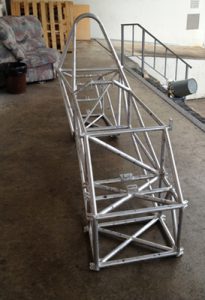

Alfe Heat Treating, sponsor of the University of Texas Austin’s Solar Power Team, helped design and build the TexSun, a vehicle with an aluminum sub-frame and chassis. The 35-pound design is much lighter than the previous model’s 80-pound steel sub-frame and chassis. “The aluminum chassis was great because it is so much lighter,” said Alfe Vice President Dan Andersen. “However, for it to be strong enough it had to be heat treated, so we had to create a special fixture to ensure the frame remained dimensionally intact and not warp into a tangled mess.”
