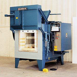

No. 854 is a special high-temperature, 2,200° F electrically-heated, inert atmosphere floor furnace from Grieve, currently used for various heat-treating applications at a customer’s facility.
Workspace dimensions measure 24˝ wide x 48˝ deep x 24˝ high. 53KW installed in heavy-gauge, high-temperature Kanthal AF alloy wire, rod overbend design heaters provides maximum operating temperatures to 2,200o F.
This Grieve furnace features 9˝ insulated walls, consisting of 4˝ thick 2,600o F firebrick, 2˝ thick 2,300o F firebrick and 2˝ thick block insulation. A firebrick plate hearth is supported on firebrick piers. An electrically-operated vertical lift door is provided, with remote foot pedal control.
Special inert atmosphere construction on No. 854 includes a continuously welded outer shell, high-temperature door gasket, sealed heater terminal boxes, inert atmosphere inlet, outlet, and flowmeter.
Safety and control equipment on-board this Grieve furnace include a digital indicating temperature controller, manual reset excess temperature controller with separate contactors and a four-channel strip chart recorder.
