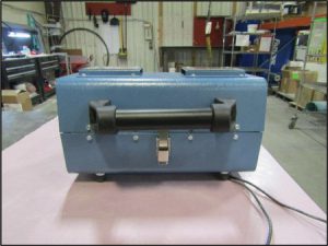

Lindberg/MPH announced the shipment of a 1200°C tube furnace for a laboratory application.
The “Mini-Mite” furnace has a wide temperature range of 500°C to 1200°C. The chamber dimensions are 1-inch-wide by 12-inch-long. The furnace includes a mild-steel hinged-shell design to allow for ease of use. Vacuum-formed ceramic fiber insulation with embedded heating elements is used for quick heat-up and low heat storage. This unit is available in either 120V or 240V rated at 960 watts. The small footprint makes this unit ideal for benchtop use. It can also be mounted horizontally or vertically. Single-zone helically coiled FeCrAl alloy heating elements are retained by refractory shapes. The furnace does not include an integral control system.
This tube furnace was completely factory assembled, pre-wired, piped, and tested prior to shipment.
