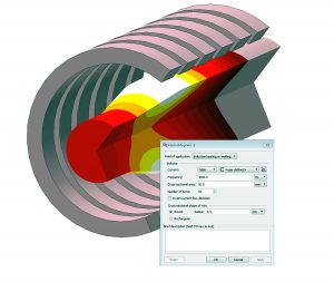

Inductive heating is used in many areas of industrial manufacturing, including heating of workpieces to forming temperature, induction hardening, and induction welding. Users can now optimize and design parts with inductive heating processes and subsequent hardening processes.
Simufact Forming helps design engineers gain a detailed insight into an inductive heating process. Users can identify errors, remove unwanted effects, and make optimizations. In designing the coil, for example, which is the core challenge of inductive heating. Simufact Forming 15 presents users with the complexity of physical context.
The required electromagnetic material properties needed for these types of workflow can be imported by the extended JMatPro interface.
