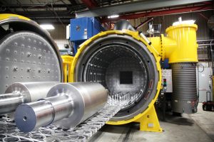

Solar Atmospheres, Inc., in Souderton, Pennsylvania, recently installed a state-of-the-art Solar Manufacturing, Inc. 74” diameter by 72” deep horizontal internal quench vacuum furnace at its Clearview Road facility. The investment totals more than $1.8 million, including additional utilities and installation. The furnace is designed to quench with argon at 10-bar while using a 600-horsepower motor running at 460 volts from a variable speed drive, and rear head moveable gas baffle doors. The goal of the massive quench system is to be able to quench larger batches of power generation castings by increasing the cooling rate and eliminating the supplemental use of helium and operating in 100 percent argon, which has proved successful in operation. The furnace incorporates Solar Manufacturing’s latest SolarVac® 5000 control system, which allows for complete process automation.
