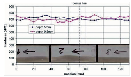

Figure 8 depicts the hardening result with the etched case (below) and with two hardening passes along the workpiece axis at 0.5 mm and 5 mm depths after tempering. The start location is still recognizable and one can see that the entire area has been hardened with a relatively constant case depth (Figure 8). With this special process technique for the inductors and sprays we create uniform hardening with no soft zone at the start location. The next critical process is at the end location where the two inductor assemblies come together.
