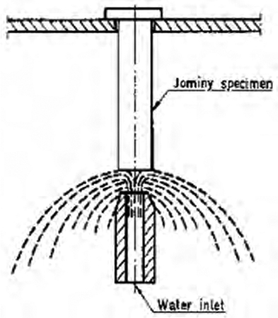

Hardenability
Large components are normally quenched in oil. Cooling below the alloy Ms temperature through to the core often takes longer than one hour, depending on the size of the cross sections. During this time, the heat is conducting through the surface. Therefore, a steel must be selected, with its ferrite/pearlite nose as far to the right as possible. Otherwise, there will be a significant decrease of the surface hardness and case depth. The larger the cross-sections, the more it is necessary to utilize high-alloyed steels.
According to the experience at Reese, for large components with a cross section more than 100 mm, 18CrNiMo7-6 or 18CrNi8, or similar steel qualities with HH-alloying-scatter-band, must be chosen. The two time-temperature-transformation diagrams (see Figure 3 and Figure 4) exhibit the differences between a high alloyed and low-alloyed case hardening steel.
The alloying elements Cr, Ni, Mo, Mn and V increase the hardenability, and V, Ni and Mo additions increase toughness. If a steel is selected with insufficient hardenability, regardless of intensive quenching in oil with very good cooling and circulation, the result will be an unacceptable drop of hardness and hardness depth of large components. This hardness reduction is evident in gear parts especially below the pitch circle down to the tooth base, to a hardness of partially well below 52 HRC. The components can fail after a short period of time by pitting, flank fractures and tooth root fractures. Using the same alloyed steels from Figure 3, Figure 4, Figure 6, and Figure 7, display the relationship of hardness as a function of the distance from the quenched end. As seen, there is an obviously much larger decrease in hardness as the distance between the quenched end grows with the low alloyed case hardening steel. The graphs created are a result of the Jominy hardenability test (Figure 5).
In the area of decreasing hardness to the tooth root, the CHD cannot be adequately modeled by the cylindrical geometry of a sample coupon. In particular, the geometric conditions and their influence on the cooling rates in massive components cannot be compared with small cylindrical test pieces. Case hardening results of the tooth base and tooth flank in comparison with a small cylindrical sample coupon are not a sufficient match of the carbon depth profile. The coupon sample should therefore be shaped such that it, in addition to a custom size, also has a greater geometrical resemblance to the tooth base. A comparison of flank and root-CHD and CHD of a ∅35 mm sample coupon can be seen in Table 2. A-F represents six companies that participated in a collaborative study FVA 501. Steel hardenability has a big influence on shape changes (shrinking and growing). Case hardening steel plants with modern computer controlled melting can specifically adjust the hardenability. It makes sense to require hardenability, grain size, and purity.
The cost is neutral for the specification for the lower 2/3 or the upper 2/3 band of hardenability. Even more favorable for the subsequent shape change, but subject to a cost surcharge, is the agreement about closer hardenability limits. Figure 8 displays possible shape change values when using case hardening steel as a function of the hardenability.
In conclusion, when selecting the material for large gear components, the geometrical influence must be taken into consideration and the following objectives must be achieved:
