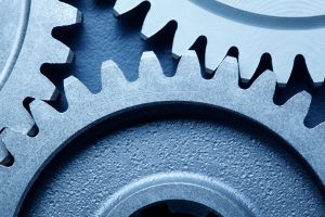

Gears play an essential role in the performance of many products that we rely on in our everyday lives. When we think about gears, we generally separate them into two categories: motion-carrying and power transmission. Motion-carrying gears are generally nonferrous or plastics, while load-bearing power transmission gears are usually manufactured from ferrous alloys. The focus here is on heat treating gears intended for heavy duty service.
To understand why heat treating is important, consider the model of material science (Figure 1), represented as a series of interlocking rings underscoring the interdependence of each element in the model. We see that the end use of performance capability of the product is defined by its mechanical, physical, and metallurgical properties, which are determined by the part microstructure, produced by a specific heat treatment process.
It is clear from this model that the manufacture of precision gearing depends, to a great extent, on heat treating as a core competency. Its contribution is vitally important for cost control, durability, and reliability. Heat treating represents a significant portion—about 30%—of a typical gear manufacturing cost (Figure 2). If not properly understood and controlled, it can have a significant impact on all aspects of the gear manufacturing process (Figure 3).
