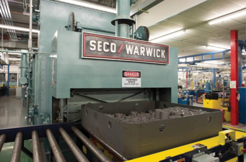

SECO/Warwick commissioned a roller hearth furnace system to ABB, an instrument transformer facility in Pinetops, North Carolina. ABB is a leading supplier of voltage and current transformers providing to utility and OEM customers.

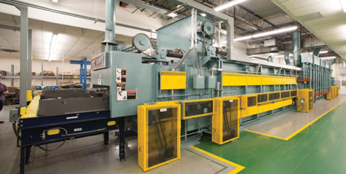

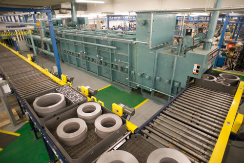

SECO/Warwick partnered with ABB to develop a system to increase capacity, provide business continuity, improve employee safety, and improve product quality by replacing three batch pit-style vacuum furnaces with a high efficiency, fully automated continuous operating system.

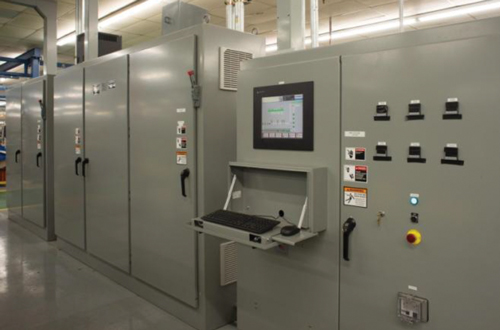

ABB engineers Mike Bricker and Jessica Warren led the project and commented, “The purchase and installation process of the roller hearth furnace was a success through hard work and strong communication between both companies. The furnace’s control system includes new technologies allowing us to track the furnace temperature throughout the annealing cycle and detect problems the moment they occur.
This information and control system provides ABB the ability to produce a stable anneal, which is critical to the electrical performance of our products. The new furnace has more than doubled our annealing capacity. The installation of the new furnace gives ABB the ability to offer lower lead times to OEM customers. The furnace and conveyor orientation was custom designed to fit in ABB’s operational space. This new layout has positively changed the flow process in the annealing area by reducing work in process and transportation time. The new system also includes safety devices that provides a safe work environment for operators and ergonomically friendly. Altogether the new roller hearth furnace has positively affected the business in Pinetops and met our needs and goals.”
The furnace is designed for continuous operation with a net capacity of 2,080 pounds/hour of wound transformer cores based on loading trays 48” wide x 48” long. The system is designed to achieve optimum temperature and atmosphere control with an automated material handling system that integrates with other plant production processes.
