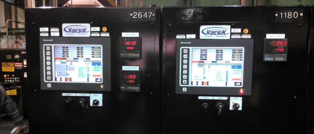

“We purchased the Honeywell HC900 controllers with accompanying SpecView software and hired them to do the full installation, a turnkey operation,” Jageman said. “They are very knowledgeable because they are constantly working and designing controllers all over the country. Not only did they install the controllers, but they also allowed us to add a little more technology that we possibly wouldn’t have thought of. So they brought a lot of experience to the table, and that helped personalize the controllers and software to fit what Modern does every day. Now that helps us provide the best documentation for our customers.”
Before the installation, Modern had obsolete operator terminals with monochrome monitors that were hard to view, and according to Kevin Helsley, one of the engineers at Conrad Kacsik who worked with Modern Industries on the project, the technology had already surpassed them. Helsley and Conrad Kacsik’s engineering team showed them demonstrations, capabilities, and solutions that they could offer.

“We replaced the controllers, the operator interface, and the PLC racks with the Honeywell HC900 PLC hybrid controller with touchscreen HMI,” Helsley said.

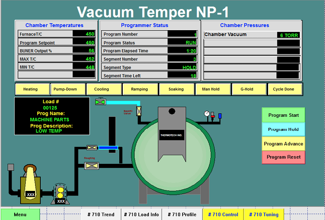

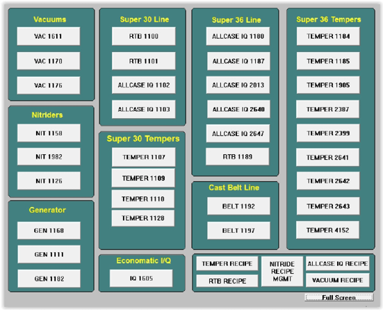

While multiple furnaces are connected on one control in the HC900, Modern Industries has the ability to look at the data individually for each furnace with the HMI touchscreen or the Specview SCADA package. Using Specview, a profile manager was developed for each furnace type within the plant. For example, this feature allows Modern Industries to develop a single profile for a furnace type and send it to 13 of their tempers at once, while they are in process.

Modern’s previous furnace-control systems consisted of standalone, menu-driven controls with monochrome displays. The operators now have a graphics-driven system, touchscreen HMIs, and an easier menu system that they enjoy working with versus the multiple menu levels. Before, they could only look at data points and try to reconstruct what happened, but now it’s visual. They can see where they stay within tolerances and that their processes ran correctly.
With the new SpecView system, authorized personnel at Modern can view what’s happening in the system while sitting at their desks. They can also access the sytem remotely through the internet. SpecView was programmed into each computer to mirror all of the individual HC900 control station screens and to provide furnace operators with recipe-management capability. Customized screens were also developed to enable customer names, part numbers, part quantities, and additional information to be combined with individual furnace data.
