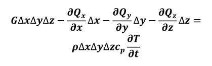

where r is the medium density and cp is the specific heat capacity, it is possible to write the thermal energy equilibrium of the control volume (Eq. 5).
[5]
Considering the Taylor series expansion (Eq. 2) the previous equation (Eq. 5) can be written as (Eq. 6).
[6]

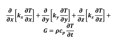

Considering heat transfer (Eq. 7) and control volume, the heat conduction equation for a stationary system in Cartesian coordinates can be expressed as below (Eq. 8).
[8]
In the previous equation k is the thermal conductivity of the considered material, which can be expressed as a following tensor (Eq. 9).
[9]

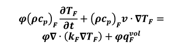

Where thermal diffusivity l=k/rcp. For porous media with isotropic behavior, negligible effects come from radiative transfer, viscous dissipation and pressure work. By assuming the local thermal equilibrium and parallelism of heat conduction between solid and fluid atmosphere, as well as a constant porosity we can write the thermal transport equation for both the solid (Eq. 11) and liquid phases (Eq. 12).
[11]
[12]
The subscripts S and F refer to the solid and fluid phases respectively, j is the porosity of the material, c is the specific heat capacity of the solid phase, cp is the specific heat at constant pressure of the fluid phase, k is the thermal conductivity, qfvol is the heat production per unit volume in W/m3[9, 13] and v= jV is the Dupuit-Forchheimer relationship. In this case, it can be observed that there is a linear relation between density and physical thermal properties.

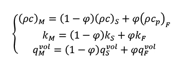

If we consider same temperature for both solid and fluid phase in the previous equations (Eq. 11, Eq. 12) we obtain the following general equation (Eq. 13).
[13.a]
[13.b]

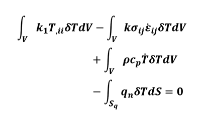

By using the divergence theorem and considering the volumetric integrals, the energy balance equation (Eq. 14) can be written as follows:
[16]
Where Sq is the boundary surface and qn represents the normal heat flux across that surface:
[17]

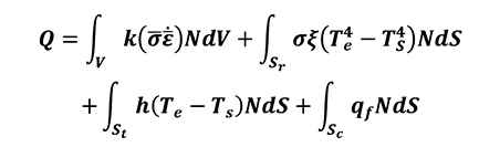

The first term on the right side of the equation (Eq. 16) represents the heat coming from the plastic deformation work. The second term represents the heat coming from radiation of environmental medium, in which s is the Stefan-Boltzmann constant x and is the surface emissivity. The third term is the heat coming from convection phenomenon from the body surface to environmental medium, in which h is the heat convection coefficient. The last term is the heat transferred between bodies in contact [5].
