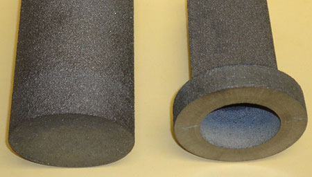

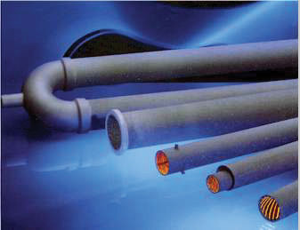

Recognizing this problem, INEX Inc., an advanced materials producer, developed a unique process to manufacture tubular forms made of Silicon Carbide (SiC), taking on the challenge to prove that failure of radiant tube heaters was not inevitable. The company focused its attention on this problem and in 1989 began producing Silicon – Silicon Carbide (Si-SiC) composite radiant tubes, which both outlast and outperform traditional metal-alloys.

Additionally, INEX tubes are less costly than both domestic and foreign competitors offering other SiC radiant tubes thanks to its unique and cost-effective Si-SiC composite manufacture. That’s a process-driven advantage. Replacing traditional metal-alloy tubes with INEX Si-SiC is a relatively simple process, as the tubes usually require only minor changes in mounting hardware. %0415_Profile_T1%%
