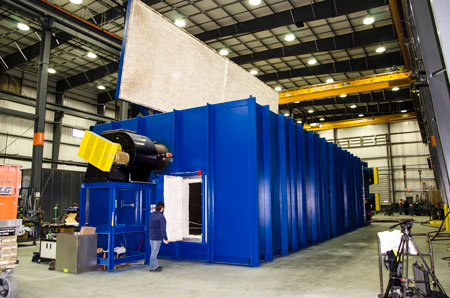

“We did one for a company that makes tanker trucks,” Grande said. “After they weld all that steel to make the tank, they have to temper it, so it doesn’t crack over time. The oven itself was 50 feet long to handle a 40-foot load, and it had a huge top load — kind of like a coffin — with a hinged top door. And the whole thing opens up, and they lower this tanker truck tank into the oven, close it up, and run it up to 1,200 degrees.”
The oven ended up with a heating chamber 50 feet long, 13 feet wide, and 12 feet high.
“It took 40 weeks — close to a year — to design and build,” he said. “And we had to achieve ±10 degrees Fahrenheit temperature uniformity.”
Customers often require a tight temperature range in an oven. The tanker oven went through a lot of testing and a lot of adjusting, according to Grande. The oven had to be certified at 40 points. In order to achieve that, thermocouple probes had to be installed at every 5-foot interval in the oven to verify the temperature stayed between 1,190 degrees and 1,210 degrees Fahrenheit.
