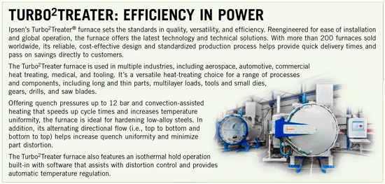

The vacuum heat-treating equipment used plays a significant role in the ability of vacuum carburizing to achieve precise process control. For example, the Turbo2Treater vacuum furnace features high quench speeds and uniform cooling and heating of parts: essential components for consistently achieving enhanced part quality and repeatability.
The Turbo2Treater vacuum furnace also offers Ipsen’s patented AvaC process, which lends itself extremely well to being used in combination with high-pressure gas quenching and can be easily integrated into production lines.

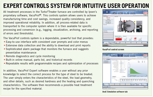

Available through Ipsen’s VacuProf® controls system, complete heat treatment cycle programs with heating, treatment, and quenching segments are created with the aid of AvaC simulation software (Figure 4). The program simulates low-pressure vacuum carburizing cycles and calculates carbon profiles that are dependent on the temperature, surface carbon content, and case depth. The calculations are based on the carbon transfer characteristics of acetylene gas.

Today’s requests to adapt the quenching intensity to the requirements for different components — specifically hardenability and minimization of distortion — lead to increased production of quality components. The Turbo2Treater furnace was designed to meet these same requirements.
The Turbo2Treater furnace attains pressures up to 12 bar using nitrogen and 8 bar using argon by utilizing a high-volume flow with vertical gas quenching. By default, the quench direction is from top to bottom. However, it can be reversed to flow from bottom to top and back. In addition, the interval at which direction changes need to occur can be set based on load temperature and time, thus allowing for a more uniform quench and part quality.
A key feature that enhances the quenching capabilities of the Turbo2Treater vacuum furnace is its use of the “Coanda Effect,” which describes the flow that follows a curved surface. Integrated into the design of the hot zone baffle, this effect makes it possible for gas to enter the hot zone in a highly uniform manner, thus ensuring the same amount of quench gas impinges on all parts to ensure uniform part quality throughout the load.
The Turbo2Treater furnace’s square hot zone is covered with a special high-performance carbon fiber composite (CFC) in either laminated form or as CFC with foil coating, which is capable of withstanding temperatures up to 3,600°F (2,000°C). The additional covering is particularly beneficial for high-pressure gas quenching as it protects the hot zone from the high-velocity gas stream. This significantly contributes to extending the hot zone service life, thus reducing subsequent servicing and maintenance costs.
