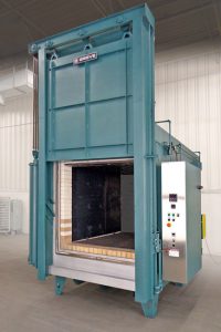

No. 1041 is a 1,400F° (760°C) inert atmosphere tempering furnace from Grieve used for heat treating at the customer’s facility. Workspace dimensions of this oven measure 48" W x 72" D x 48" H, and 120 KW are installed in nickel chrome wire coils supported by a stainless steel frame, while a 9,600 CFM, heat-resistant alloy recirculating blower powered by a 15-HP motor provides vertical upward airflow.
This Grieve inert atmosphere tempering furnace has 7-inch-thick insulated walls comprising 5-inch-thick 2,300°F ceramic fiber blanket and 2-inch-thick 1,900°F block insulation. Features include inner walls clad with 304 stainless steel, 304 stainless steel ductwork, and a stainless steel subway-grating hearth. Other features include ¼-inch plate steel exterior reinforced with structural steel, ½-inch steel face plate at doorway, and an air-operated vertical lift door. Inert atmosphere construction includes continuously welded outer shell, high temperature door gasket, sealed heater terminal boxes, inert atmosphere inlet, inert atmosphere outlet, inert atmosphere flow meter, and manual gas valve.
Controls on the No. 1041 include a digital-indicating temperature controller, a manual reset excess temperature controller with separate contactors, recirculating blower airflow safety switch, and a digital batch timer with alarm.
