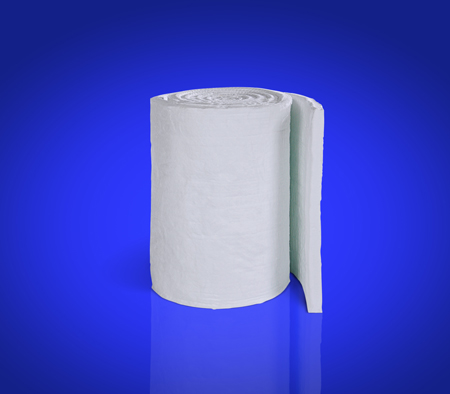

For traditional repairs, the furnace must be shut down and cooled until it is safe for maintenance personnel to enter and repair the lining with fiber blankets, pumping solutions, or monolithics.

Some repairs identified by infrared thermology scanning can be too large to address on-line, and instead, the unit must be shut down for a furnace reline or process heater reline. In this scenario, it is important to select the right refractory materials to facilitate a successful furnace rebuild. This will lead to greater efficiency, reliability, and lower maintenance costs.
