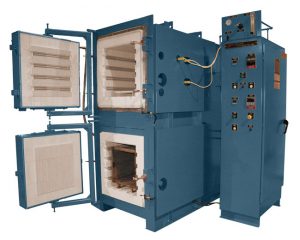

L&L Special Furnace Co., Inc., shipped a dual chamber heat-treating furnace to a U.S. manufacturer of items used to produce heavy equipment and transportation devices.
The furnace will be used to heat-treat the tooling used to manufacture these items. Its top chamber is used to harden tool steels while its bottom chamber is used for tempering, stress relief, and pre-heating.
The L&L model QD836 furnace’s hardening chamber has an effective work zone of 16” wide by 16” high by 32” deep. The tempering chamber has an effective work zone of 14” wide by 14” high by 32” deep. The top chamber has a uniformity of ±20° above 1,200°F and the bottom chamber has a uniformity of ±10°F from 300°F to 1,250°F.
The furnace is controlled by Eurotherm temperature controls with overtemperature protection. Solid-state relays drive the electric heating elements and include heavy-duty, long-lasting 11 Ga. thermocouples.
All controls and fusing are in a side-mounted NEMA1 enclosure.
