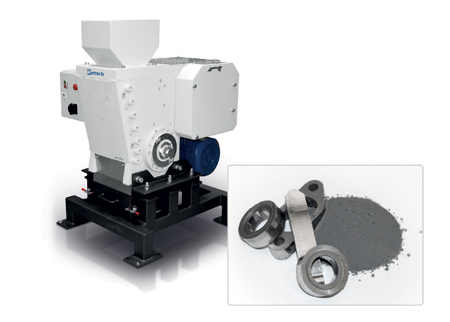

Jaw Crushers such as Retsch’s BB 500 XL, pulverize defective green parts, brown parts, or hard metal parts within minutes.
Application example: 10 kg of green parts < 100 mm were crushed in two batches with closed gap (i.e., direct contact between fixed and moving crushing arm) in the Jaw Crusher BB 500 XL. Each batch was pulverized to a final fineness of 85 percent < 250 μm after only one minute.
