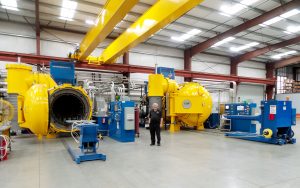

Solar Atmospheres of California (SCA) is pleased to announce the completion of its most recent facility expansion. The new expansion allows SCA to double its current heat-treating capacity on the West coast while continually striving to meet the needs of an ever-growing customer base.
Project expansion began in July 2016 with ground breaking for a new 25,000-square-foot building. Upon completion of building construction in July 2017, and applying the lessons learned from SCA’s initial facility build in 2010-11, SCA immediately began the design, fabrication, and installation of all required support systems including water and gas delivery.
In preparation for the added growth, SCA has procured an additional four vacuum furnaces from sister company Solar Manufacturing (SMI), based in Souderton, Pennsylvania.
