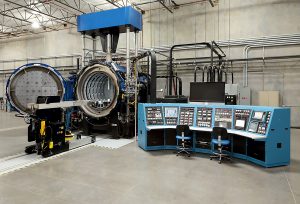

Solar Manufacturing has successfully completed the installation and startup of a 100-ton force Vacuum Hot Press that includes a 2-Bar Gas Fan Quench cooling system (GFQVHP) for Refrac Systems’ commercial and aerospace diffusion bonding operation in Chandler, Arizona.
Working with Solar’s engineering team, Refrac Systems selected a derivative of the Solar Manufacturing standard HLF-5748-2IQ internally quenched 2-Bar vacuum furnace as the base design. The furnace hot zone was modified to contain a 100-ton load hydraulic ram centered over the zone which is configured to diffusion bond parts up to 36” wide x 48” long x 30” tall.
The world’s first 100-ton vacuum hot press with gas fan quench cooling capability for up to a 4,000-pound part is now installed and in commercial operation at Refrac Systems. (Courtesy: Solar Manufacturing)
Besides being specifically designed to diffusion bond large plastic injection molding dies, and concurrently quench hardening them, the system is finding applications in bonding advanced superalloy heat exchangers where the quench cooling offers significant improvement on performance.
